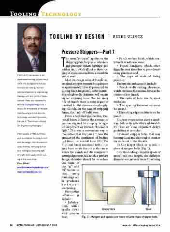

Stripper construction plays a signif- icant role in die reliability and durabil- ity. Here are some important design guidelines to consider:
1) Avoid stripper bolts that may become loose and also tend to break at the undercut of the threads.
2) Use keeper block or spools in place of stripper bolts (Fig. 1).
3) If the die design requires spools of more than one length, use different diameters to prevent them from being

    Keeper block Spool

Fig. 1—Keeper and spools are more reliable than stripper bolts.
