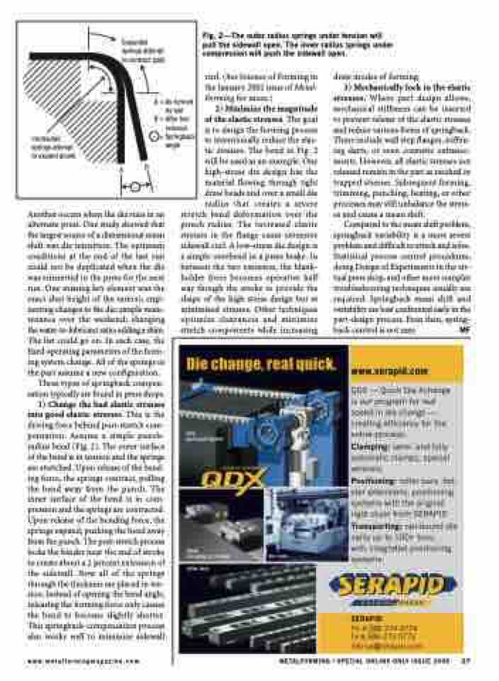

 Contracted springs attempt to expand (push).

2) Minimize the magnitude of the elastic stresses. The goal is to design the forming process to intentionally reduce the elas- tic stresses. The bend in Fig. 2 will be used as an example. One high-stress die design has the material flowing through tight draw beads and over a small die radius that creates a severe

Three types of springback compen- sation typically are found in press shops. 1) Change the bad elastic stresses into good elastic stresses. This is the driving force behind post-stretch com- pensation. Assume a simple punch- radius bend (Fig. 2). The outer surface of the bend is in tension and the springs are stretched. Upon release of the bend- ing force, the springs contract, pulling the bend away from the punch. The inner surface of the bend is in com- pression and the springs are contracted. Upon release of the bending force, the springs expand, pushing the bend away from the punch. The post-stretch process locks the binder near the end of stroke to create about a 2 percent extension of the sidewall. Now all of the springs through the thickness are placed in ten- sion. Instead of opening the bend angle, releasing the forming force only causes the bend to become slightly shorter. This springback-compensation process also works well to minimize sidewall
stretch bend deformation over the punch radius. The increased elastic stresses in the flange cause extensive sidewall curl. A low-stress die design is a simple overbend in a press brake. In between the two extremes, the blank- holder force becomes operative half way though the stroke to provide the shape of the high stress design but at minimized stresses. Other techniques optimize clearances and minimize stretch components while increasing

A
B
Expanded springs attempt to contract (pull).
A = As-formed by tool
B = After tool removal
– = Springback angle
Fig. 2—The outer radius springs under tension will pull the sidewall open. The inner radius springs under compression will push the sidewall open.
