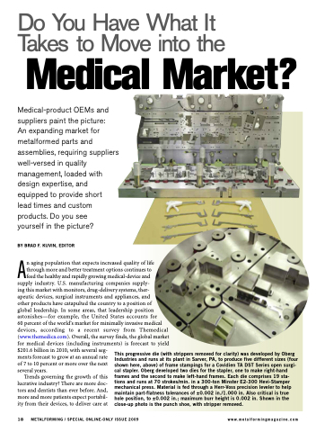

This progressive die (with strippers removed for clarity) was developed by Oberg Industries and runs at its plant in Sarver, PA, to produce five different sizes (four shown here, above) of frame stampings for a Covidien TA DST Series open surgi- cal stapler. Oberg developed two dies for the stapler, one to make right-hand frames and the second to make left-hand frames. Each die comprises 19 sta- tions and runs at 70 strokes/min. in a 300-ton Minster E2-300 Hevi-Stamper mechanical press. Material is fed through a Herr-Voss precision leveler to help maintain part-flatness tolerances of ±0.002 in./1.000 in. Also critical is true hole position, to ±0.002 in.; maximum burr height is 0.002 in. Shown in the close-up photo is the punch shoe, with stripper removed.
