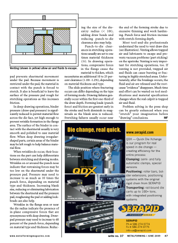

 Venting (shown in yellow) allow air and fluids to escape.

Most tool-and-die professionals understand the need to vent draw dies (see illustration). Venting allows trapped air and lubricants to escape and pre- vents vacuum problems (part sticking) on the upstroke. Venting is very impor- tant for stretching operations, too. If venting is not provided, trapped air and fluids can cause bursting or frac- turing in highly stretched areas. Unfor- tunately, after the breakage occurs, the fluid and air are released and the root- cause “evidence” disappears. Much time and effort can be wasted on tool mod- ifications and material specification changes when the real culprit is trapped air and fluid.
