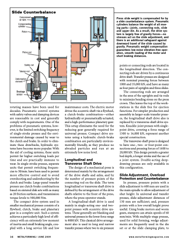

 Slide Counterbalance
Compressed air tank
Compensating cylinder
Piston
Piston rod
Safety rod Tubular rod
Deformation element
Breakage sensor

Press slide weight is compensated for by a slide counterbalance system. Pneumatic cylinders balance the weight of all mov- ing parts—joints, connecting rods, slide and upper die. As a result, the drive sys- tem is largely free of gravity forces—no stresses act on the slide adjustment, and there is an additional safeguard against downward travel of the slide caused by gravity. Pneumatic weight compensation guarantees low-noise vibration-free oper- ation, smooth loading of the motor and short braking distances.
