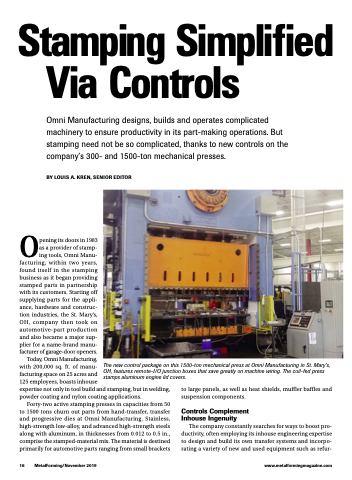

The new control package on this 1500-ton mechanical press at Omni Manufacturing in St. Mary’s, OH, features remote-I/O junction boxes that save greatly on machine wiring. The coil-fed press stamps aluminum engine lid covers.
