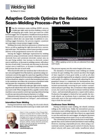

 Wheel starts to roll up onto the part
Current starting after wheel already is rolling up onto part, resulting in undersized weld on front edge
Displacement data (top) and current data (bottom) collected with WeldView monitor

Fig. 1—When applying current too late, an undersized front-edge weld results.
