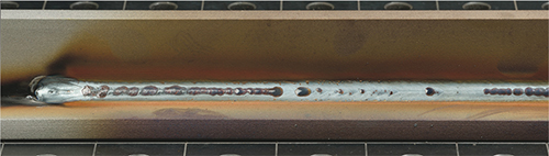

Filler-metal manufacturers have responded to customer demand for such materials with S-6 filler wires that combine enhanced compositions and innovative coating technologies. The enhanced metallurgy reduces overall formation of silica islands, and creates a slag that self-releases or easily brushes off (Fig. 2). As a result, users spend more time engaged in productive activities and less time cleaning. For example, a construction-equipment OEM reduced arc-ignition errors by 66 percent in multipass applications (Fig. 3) using an enhanced S-6 wire. Previously, excess silica islands prevented positive arc ignition. When this occurred, the manufacturer needed to shut down a robotic-welding station and spend an average of 3 min. to clean the silica islands. With a rate of $280/hr. in the station, each stop cost $14.

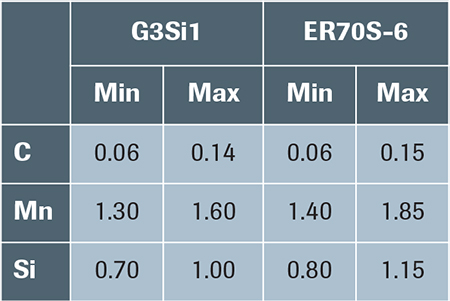

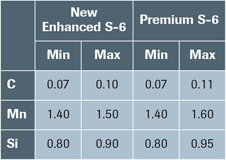

Batch-to-batch consistency, especially in robotic applications, also can be an issue. To address this, wires with enhanced metallurgy use a tightly controlled range for the primary alloying elements of a mild-steel wire (carbon, manganese and silicon), as well as tightly controlled amounts of as many as 17 raw elements (Fig. 4).
By way of comparison, the acceptable range for alloying elements is fairly broad (Fig. 5). As a result, standard S-6 wires open themselves up to significant variations in batch-to-batch performance, which in turn can create the need for constant fine-tuning of welding parameters. If spatter levels increase, one culprit could be a change in metallurgy.
Enhanced S-6 wires also provide good puddle fluidity. As Fig. 6 shows, these wires provide a flat bead profile and excellent tie-in at the weld toe. They can reduce or eliminate the need for gas-tungsten-arc dressing or grinding to remove stress concentrations, which may be required in other situations.

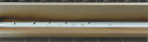

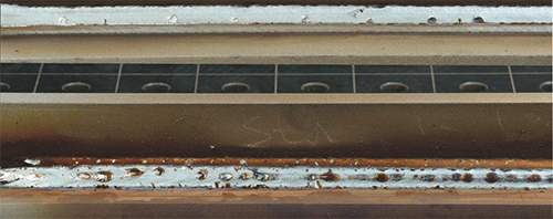

For applications where flaking is an issue, premium noncoated wires are an option, as they generate far fewer particles and enable a longer run time between scheduled maintenance and liner and tip replacement (Fig. 7). These wires feature a proprietary coating that is not obvious to the naked eye.
To confirm performance, Esab worked with ISF Aachen, a German welding-research authority, to conduct a benchmark survey that compared premium noncoated wires with a wide selection of copper-coated wires. Results prove that the noncoated wire runs longer without burning back to the contact tip (more than 330 min. of continuous welding compared to 220 min. or less for copper-coated wires), requires less force to feed, increases arc stability and reduces spatter.
