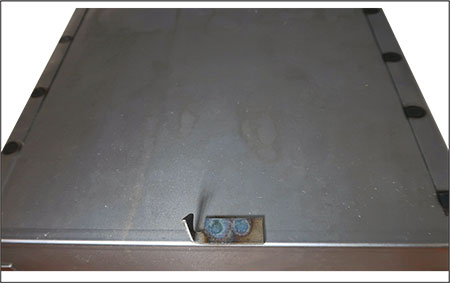

Weld Spacing and Projection Welding
Here’s an ideal application to convert from spot to projection welding. Welding the small tab causes weld expulsion and weakens the joint. Also, insufficient spot spacing causes the second spot to be weaker than the first due to current shunting.
Another critical design specification: center-to-center spot-weld spacing. Since electricity always takes the path of least resistance, a second spot weld made too closely to the first will be weak, because part of the weld current shunts through the existing weld. Looking again at the example above (welding 18-gauge mild steel), specs call for a minimum weld spacing of 7⁄8 in.

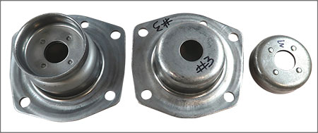

Where the design calls for tighter weld spacing, consider using projection welding. This resistance-welding process employs projections formed onto one of the parts. The projections, which can have single or multiple embosses of various shapes, concentrate the welding current exactly where the joints need to form. Of all of the resistance-welding processes, projection welding offers the most potential for productivity increases, so metalformers should consider the process even if they must redesign the part and fabricate new tooling.
Many spot-welded sheetmetal assemblies can be projection welded if they already have flanges that will accept the projections. With proper technique, the consistency of joints made by projection welding may greatly exceed that of a typical spot-welding operation.
(Note: If designers have the option to use three or four projections, they should use three for optimum weld-force equalization.)
This projection-welding process employs projections formed onto one of the parts (in this case, the drawn cup to the right). The projections, which can have single or multiple embosses of various shapes, concentrate the welding current exactly where the joints need to form.
