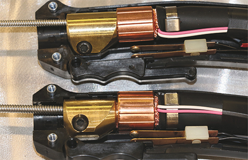

GMAW guns
The larger the welding cable, the more heat it dissipates. These guns have the same handle diameter but use different size cables. The top gun has a rating of 250 A at 60-percent duty cycle while the bottom gun with its larger cable yields a rating of 450 A at 60-percent duty cycle.

The GMAW gun and consumables serve as the contact point for transferring electric current from the tip to the welding wire, as well as to direct the welding wire and shielding gas (if required) to the workpiece. They also dissipate the heat generated by the welding process and the electrical resistance in the system.
Like power sources, guns have thermal duty-cycle ratings, governed by IEC 60974-7, Standard for Arc Welding Equipment. The standard requires (among other things) temperature-rise tests for the gun handle and cable. Based on how well their construction dissipates heat, GMAW guns and consumables are classified as light-, medium- and heavy-duty. Respective examples of duty-cycle ratings would be 180 A at 40 percent, 250 A at 60 percent and 400 A at 60 percent.
How hard a gun works depends on wire diameter, welding parameters, and process and service conditions such as arc-on time and environmental conditions. Short-circuit GMAW with a 0.030-in. wire in a muffler shop would be considered light-duty work. Pulsed GMAW with a 0.035-in. wire would be medium- to heavy-duty work, and spray-transfer GMAW welding or flux-cored with a 0.045-in. wire or larger would be heavy-duty work.
“For anything surpassing sheetmetal work with a 0.030-in. wire, I recommend at least a medium-duty setup that has a 250- or 350-A rating at 60-percent duty cycle. The larger cable will keep the gun cooler and lower primary power draw, plus it will come with a better set of consumables compared to a light-duty gun,” says Galen Johnson, senior lab technician at Esab’s Welding & Cutting Products’ test lab in Denton, TX, and a professional welder since 1968.
Johnson also reminds welders that guns have different ratings when used with different shielding gases. “Pure CO2 is a reactive gas that provides deep penetration but produces less stable arc and more spatter,” he says, “while mixed CO2 with a higher argon content produces more-stable arc, reduced spatter and allows the use of spray transfer process for higher productivity and better-looking weld beads. Application variables always influence gun selection.”
