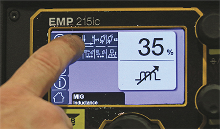

Inductance Control
…works with the short-circuit GMAW process to help reduce spatter and control puddle fluidity. With short-circuit GMAW, the arc turns on and off perhaps 150 times/sec. As the wire dead-shorts into the plate, voltage reaches zero; the current then rises to clear the short and the voltage rises as the arc becomes established.
Wire feeders that offer one-knob synergic control allows welders to easily fine-tune the arc.
Inductance controls the rate of rise of short-circuit current. The rate can be slowed so that the short may clear with minimum spatter.
Inductance also stores energy and then supplies this energy to the arc after the short has cleared, to create a longer arc. Inductance also increases the amount of arc-on time. This, in turn, makes the puddle more fluid, resulting in a flatter, smoother weld bead and perhaps better tie-in at the toes of the weld. The opposite is true when inductance is decreased.
When using solid mild-steel weld wire, use inductance to help control spatter. Generally, use higher inductance values with thicker workpieces and lower inductance on thin work. Solid stainless-steel wires are notorious for creating weld beads with a high crown and ropey bead appearance. Here, a longer arc-on time improves wet-out, flattens the crown and enhances bead aesthetics.

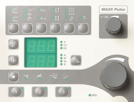

Programmable Memory and Synergic Lines
In job shops, welding operations differ from day to day. Each new job requires setup time and parameter testing. In large operations, manufacturers want all operators across all shifts and all plants to produce consistent results. While very different, both types of companies will benefit from a wire feeder/ controller that offers a programmable memory function, or a synergic machine.
Programmable memory can feature varying degrees of sophistication, from enabling a user to set and recall parameters to providing parameter-adjustment limits. Either way, being able to recall parameters can save hours of setup time and more than a few pounds of scrap depositing test welds.
Synergic lines come with programmed parameters established by factory technicians to deliver optimum results for specific combinations of wire type and diameter, welding process and shielding-gas composition. They also include preset values for creep start, burnback and the other functions noted above; these functions can be toggled on or off in some systems, and they can be adjusted in others.
Several control panels enable one-knob synergic control and will automatically adjust all welding parameters, including those for pulsed welding. Basically, the welder turns the knob one way to weld hotter and faster and the other way to weld slower and cooler. Further, when a welding engineer has determined that a part needs a 1⁄4-in. fillet weld, for example, using particular voltage and WFS settings, synergic controls enable parameter limits—operators can spin the knob all they want and they won’t weld out of spec. Further, to obtain good results, operators need only focus on GMAW-gun mechanics.
Quick Set
While called different names among systems and manufacturers, quick set and smart GMAW functions take performance beyond that of a synergic line. After engaging the quick-set function, the wire feeder will automatically select the optimal short-circuit frequency for the wire/gas combination used. The operator makes a short test weld, and in about 3 to 6 sec. the machine will automatically fine-tune performance. The operator will actually hear the arc as it adjusts to that perfect “sizzling-bacon” sound of the short-circuit GMAW process, with spatter minimized.
Quick set provides smart control. Regardless of the wire type and gas combination used, the control automatically fine-tunes the arc without any need for programming. To weld hotter or colder, the operator simply adjusts a single knob, typically the WFS-control knob. Quick set ensures that all parameters will automatically track. On some systems, the operator may have the option to adjust trim (which is really voltage), to flatten a high crown or otherwise adjust bead profile. Because advanced systems also have memory functions, the operator can store and recall these settings. MF
