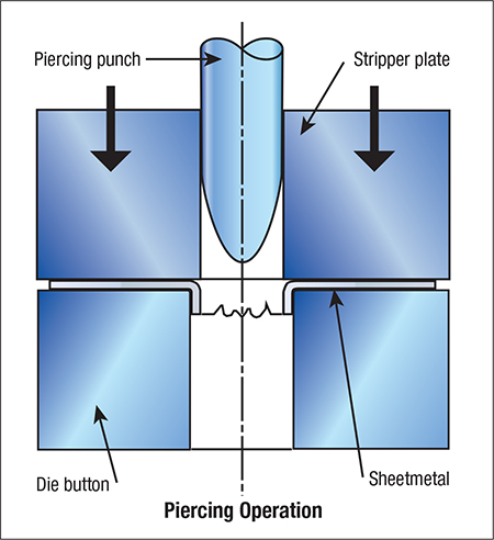

Another source of confusion relates to hole-making terminology. Are they punched or pierced? We can differentiate between punching and piercing by emphasizing the fact that punching produces a slug, piercing does not. Piercing operations often (but not always) are defined as “forming a hole in sheetmetal with a pointed punch with no material fallout” (see the accompanying figure).
