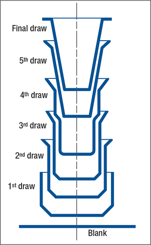

Cups with tapered walls are sometimes referred to as cones. Drawing a cone shape directly from a flat blank requires substantial blankholder forces. There’s high likelihood of the part material breaking early in the punch stroke due to the small punch-face diameter and tight radius in the bottom of the cup. Successfully drawing a cone-shaped cup requires a stepped-cup approach.
Step-cups have two or more body diameters within the shell. Step-shells are produced by stopping the redrawing process partially through the press stroke. Thus, only a portion of the shell is redrawn, with the stepped shell drawn into a cone in the final draw after appropriate step reductions (Fig. 1).
