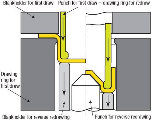

Two basic redrawing methods exist for cylindrical shells: direct redrawing and reverse redrawing. Direct redrawing (Fig. 1) reduces the cup diameter by redrawing in the same direction as the first draw. In reverse redrawing (Fig. 2), the cup inverts inside out in order to reduce its diameter. Redrawing, often performed with an internal blankholder, as depicted in both figures, also can be accomplished without a draw sleeve (internal blankholder) when using smaller-diameter reductions.
Regardless of the method, the percent reduction in the redraw operation always will be less than the first draw because sheet metal hardens as it deforms or is cold worked. Subsequent redrawing operations induce more work hardening, thereby reducing the percent reduction achievable for subsequent redraws.

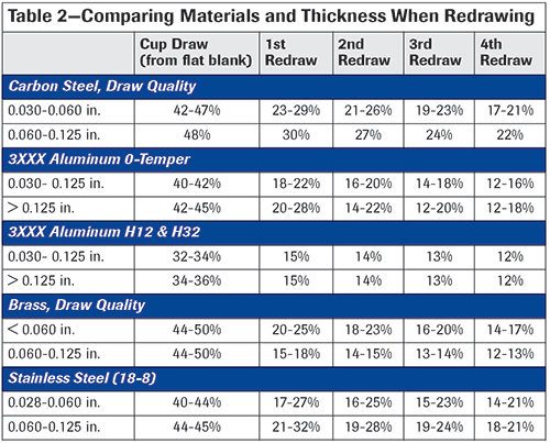

Because thick materials can stretch farther than thin materials, drawing reductions usually get reported as a function of material thickness. Due to differences in work hardening behavior, surface topography and other factors, draw reduction tables often are material type-, grade- and temper-specific. Table 2, adapted from a variety of sources, illustrates the differences between select grades and thickness ranges. In general, be conservative with aluminum alloys unless you have previous experience with the alloy and temper with which you are working.

Fig. 2—In reverse redrawing, the cup inverts in order to reduce its diameter.
