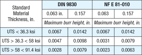

Today, metalformers should use standards—not rules of thumb—to establish burr-height limits on stamped parts. Two such standards: DIN 9830 (German) and NF E81-010 (French). Both classify acceptable burr heights relative to the workpiece-material thickness and its tensile strength.
The illustration includes an excerpt from each standard for a precision-punched hole in 0.063-in.- and 0.157-in.-thick material. Notice that the maximum burr allowance for 0.063-in. sheet with a tensile strength less than 36.3 ksi is 0.0067 in. per side. This follows the 10-percent rule of thumb. However, as the tensile strength for the same material thickness increases to 90 ksi, the maximum allowable burr drops to 0.0023 to 0.0028 in.
When material thickness is increased to 0.157 in., the allowable burr height for the 36-ksi and 90-ksi materials are, respectively, 0.0142 in. and 0.0063 to 0.0079 in. (less than 10 percent of material thickness). Certainly, most stamping-shop customers would not accept 0.016-in. burrs (10 percent of 0.157-in.-thick material) on any of their products. MF
