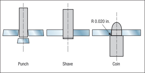

A Three-Step Process
Fig. 2—A hollow-ground shave punch
For maximum extrusion heights, the best solution is to create the hole in three singular steps: punch, shave and coin the bottom side prior to forming the extrusion (Fig. 1). For most materials, the amount of material to be removed by shaving usually equals 10 percent of material thickness. This provides good surface finish and leaves enough material in the scrap ring for slug retention. This is important, because slug retention generally is considered the most common problem associated with shaving operations.

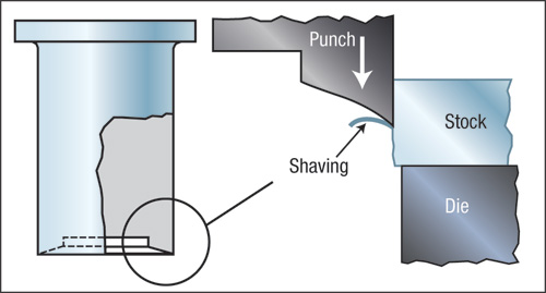

Shaving really is more of a machining operation than a punching operation. A properly shaved hole will induce less cold working on the edges than will a tight-clearance punched hole.
To promote the cutting action, consider adding a back-rake angle on the shave punch face. This would be similar to the rake angle found on a machine cutting tool. As an example, see Fig. 2 of a hollow-ground shave punch (courtesy David Smith and Associates). This modification can improve surface-finish quality and extend punch life.
After the hole has been shaved, coin a small (0.020-in. dia.) radius on the bottom side to compress any burrs that may serve as stress risers.
