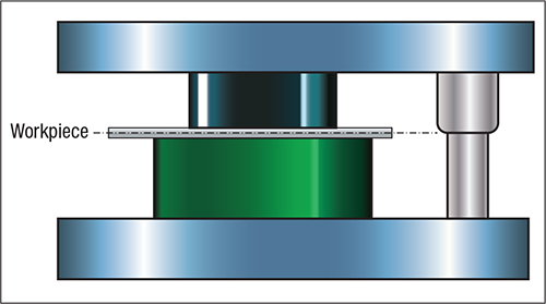

 guide bushing should engage the post at the working level of the die
The guide bushing should engage the post at the working level of the die.

The guide bushing should engage the guide post at the working level of the die whenever possible (see illusration). This loads the guide post in a shear condition—its strongest condition—and imparts little or no bending moment that can cause the guide post to deflect, resulting in misalignment between the upper and lower die halves.
Oftentimes the bushing is placed much higher than the work, out of convenience or to eliminate the cost of welding and machining a mounting boss. Avoid this poor design practice.
The guide post should bypass the end of the guide bushing with the die closed. This ensures uniform wear along the entire length of the bushing. The guide pin should bypass the bushing at least ¼ in. past lead angles.
Keep guide-post length to a minimum. Conditions that provide the shortest guide post, while satisfying all of the functional requirements of the die, provide the best design. When working within commercially available sizes, choose the shortest guide post that will provide the desired engagement and bypass.
