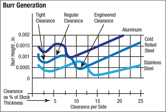

Fig. 1--Burr height and cutting clearance relationship, courtesy Dayton Progress
Fig. 1—Burr height and cutting clearance relationship, courtesy Dayton Progress

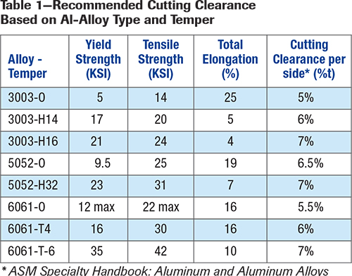

Table 1--Recommended Cutting Clearance Based on AL-Alloy Type and Temper

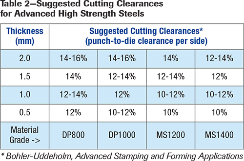

Table 2--Suggested Cutting Clearances for Advanced High Strength Steels

Fig. 1 easily debunks this over-generalized rule. While a 10-percent cutting clearance per side may be ideal for cold-rolled steel, for stainless steel it leads to excessive burr height. It also is to large for aluminum stampings.
Although very useful, Fig. 1 only provides guidelines based on the specific grade tested within the different material types. The ideal cutting clearance for aluminum, for example, depends on alloy type, temper and sheet thickness. Table 1 provides suggested punch-to-die clearances, in terms of percent of sheet thickness (t), for three different grades and tempers of aluminum.
Cutting clearance in a stamping die provides leverage to bend and break the slug free from the parent material. As material strength increases, so does the required amount of clearance, to provide additional leverage to break the slugs free from the stronger parent material. Thus, when stamping higher-strength steels, the required cutting clearances can be twice as great as those required for aluminum (Table 2).
