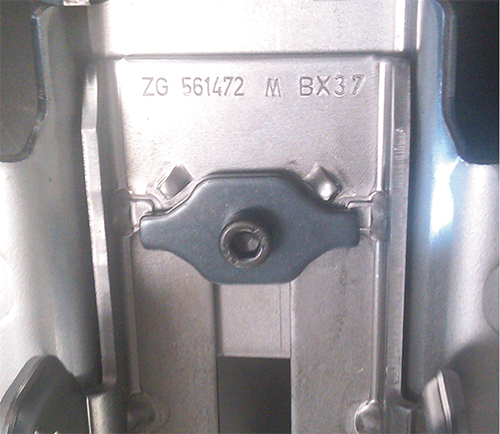

lot traceabilityLot traceability effectively means that a manufacturer knows which lots of product were used in which finished goods, and who received those finished goods. A key component in many ERP systems, lot traceability provides companies with a way to track problem products from their customer all the way back to the suppliers who provided materials and processes in between.
