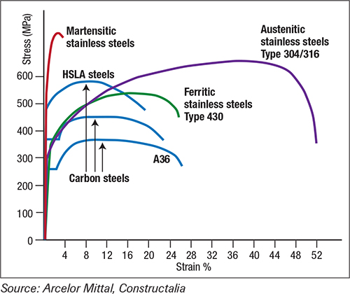

Many stainless-steel grades have workhardening rates much greater than those for mild steel, which leads many to believe that stainless steels are less formable than low-carbon grades. In reality, stainless steels are very formable (see accompanying figure), and many grades are substantially more ductile than mild steels. Some stainless steels can be deep-drawn into very complex shapes without the need for intermediate annealing, and even the less formable ferritic grades have outstanding ductility.
