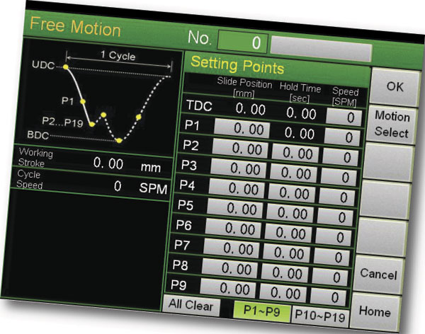

A servo press’s programmable slide speed, position and dwell (Fig. 2) will open your mind to creative drawing processes and in-die activities such as insertion and welding. But this versatility introduces new strains, twists and forces on the press frame. A conventional gap-frame, straightside, or tie-rod-constructed press may lack the rigidity necessary to hold tight tolerances under longer dwells and draws, causing the frame to stretch and elongate. To prevent this, some press manufacturers employ a monoblock or honeycomb frame design. These presses are designed with low-impact speed in mind, and are intended to “box-in” horizontal and parallel support on the slide and bolster, located in the center of the frame. Thus, all support is targeted to where it’s needed most, reducing the risk of press damage, as well as floor space.

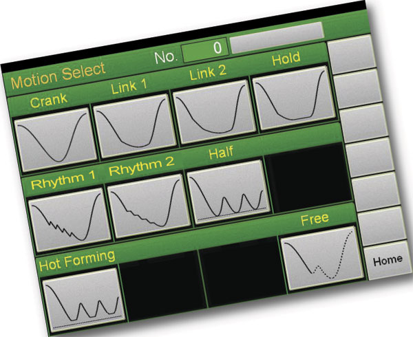

Every manufacturer gives you a means to select and adjust preprogrammed stroke profiles or create freestyle profiles (Fig. 3). Beyond that, a servo-press controller should offer more than what you’re used to. You should have more standard s to integrate and orchestrate peripherals, a robust back end for collecting and analyzing data, and a user-friendly front end to put that data to use. The controller is the key to making your servo investment pay off. If you’re not using the most up-to-date and scalable control technology, you’ll soon be upgrading and paying more. MF
