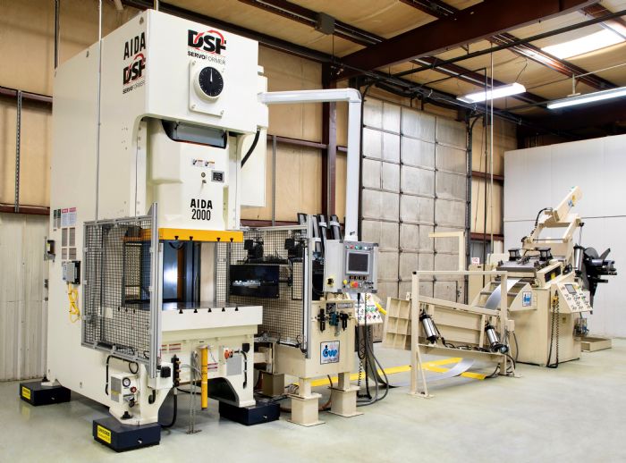

In addition to its decorative stainless-steel business, Henderson Stamping also processes tons of mild steel—think brackets and other structural components that customers order by the millions. Which brings us to the latest press to hit the production floor at Henderson Stamping, a 220-ton gap-frame servo press (an Aida DSF-C1-2000A), the third servo press added since 2020. This latest press addition earned Porter’s trust when he landed an important new project from a long-term customer.
“I’d been working to land this program for several months,” he says, “calling for 10.5 million stampings/yr. for a key appliance customer. We sought to add a press (late in 2020) that we could dedicate nearly entirely to this specific job, to ensure that we’d have the capacity to meet the customer’s needs without taking anything away from other customers and projects. Aida was able to provide (in March 2021) the perfect press for the job, including the control package we sought. It shipped and installed the press in just a matter of months. Their team knocked it out of the park.”
The part in question: an oven bracket (approximately 8 by 1 in.) stamped from 0.030-in.-thick mild steel in a 10-station progressive die. Why a servo press?

Case in point: a gusset plate stamped for a dryer top that once ran at 40 strokes/min. in a 110-ton conventional mechanical press, which now runs in pendulum mode in the new Aida servo press at 134 strokes/min. So, when it comes to stamping the new brackets for which Porter specifically purchased the new press, “we’re at 110 strokes/min.,” he says, “but expect to reach 130 strokes/min. once we install some new part-out sensors to verify that we’re successfully moving stamped parts out of the die.”

For the new Aida, Henderson Stamping added a 25,000-lb.-capacity coil line from CWP that can process much larger coils than most of the firm’s other progressive-die presses. The line is rated for a maximum 24-in. coil width, with a minimum 16.5-in. core diameter and 60-in. maximum coil OD. The line includes a leveler rated for 24-in. material with maximum sheet thickness of 0.187 in., and can level as much as 100 linear ft./min.
Press Specs
As for key press specs, the DSF-CI-2000A boasts 58 in.-tons of working energy at 0.2 in. from stroke bottom, with a 9.8-in. stroke length, 17.2-in. die height and 57.9 by 33.1-in. bolster area. “Most importantly, though,” explains maintenance supervisor Joey Puckett, “is the Allen-Bradley control—it’s superior to anything else we have here. For example, we’re not limited in terms of the number of programmable limit switches (PLSs) that we can implement, while some of our other presses only allow us to implement six or eight PLSs. In addition, we use Allen-Bradley elsewhere in the plant, so our maintenance technicians are well-versed in how to work with the press control. Finally, we easily can interface the press with our other equipment to help us track part counts, quality and press uptime.”
