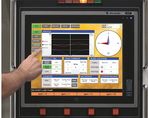

It is commonly accepted that servo-driven presses bring advantages when working with complex parts and challenging materials, but the same can hold true for dedicated part runs where users can take the time to fully optimize servo-press motion profiles. Fewer jobs and longer runs allow for full profile optimization that can net productivity improvements of 50 to 75 percent.

Patil: For stamping dedicated products, ROI is in fact quicker. In applications that we have studied, ROI for the premium is nine to 12 mo. For a dedicated part run, where you may run the same or similar jobs 24/7, you can fully optimize the motion profile because you can take more time to arrive at the ideal profile. When running a greater variety of jobs, a stamper cannot optimize every job to the fullest extent due to the need to keep up with production and with customer demands. Fewer jobs and longer runs allow for full profile optimization and productivity improvements of 50 to 75 percent, thus the reduced ROI.
These ROIs are not even considering improvement in tool life and part quality, and reduction in scrap and setup time. Also, some stampers, because press speeds can be reduced and optimized during forming, use less lubrication, which also assists in a more rapid ROI.
Importantly, as with any newer technology, to get the most out of servo-driven presses and realize the greatest energy savings, highest part quality, and most rapid ROI, users must be educated and trained. Metalformers should be developing servo-technology champions that keep abreast of techniques and stay sharp and informed via training. These champions can take the lead in optimizing motion profiles and matching presses to auxiliary equipment such as press feeds and transfer systems. Metalformers should partner with their press manufacturers in order to get the most bang for their buck with servo-press technology. As with any new tool, if you are not trained you will run it like the old tool and not realize its full benefits. MF
