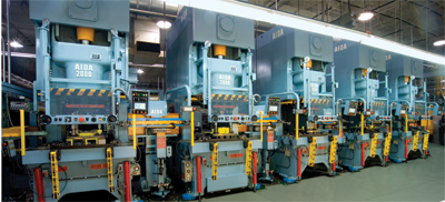

Transfer lines
Transfer lines—this one comprised of servo-driven gap presses—help stampers minimize costs and run lean. Photo courtesy Newman Technologies S.C.
