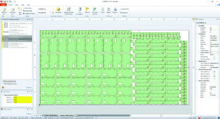

What proved so persuasive in those bullet points? Here’s an example: One PowerPoint slide on part-nesting capability showed a nest of 187 parts on a first-attempt ProNest-programmed sheets as compared to 178 parts via the previous software, resulting in saving one full sheet ($320) on a job. And, ProNest required 1 min. of programming for this job as compared to 30 min. for the old software. Another: For estimating, with the feed rates, workcenter rates and material costs integrated into ProNest, the software creates 99-percent-accurate laser-operation prices. And, estimators can use PDF and DXF files to create quotes, with the software’s AutoNest module enabling one-click identification of the optimal sheet size in inventory for that particular part, and creating an accurate quote in about 1 min. depending on part complexity.
Today, with ProNest in place and running on laser cutting machines across multiple locations, Toop and laser cutting operators, programmers and estimators make use of various software features to save money and time, including these key modules:
- Automatic Nesting enables one-click nesting. Users can choose their preferred nesting strategy to control the balance between nesting speed and material utilization, or select IntelliChoice for the software to determine an algorithm-based strategy.
- Nesting System Optimization determines the ideal sheet size for a particular set of parts. The module reportedly calculates every possible combination of parts, plates, remnants and different nesting strategies until it finds the best possible outcome.
- Common Line Cutting enables sharing of the common edges of adjacent parts. This feature can be applied automatically to similar parts or manually for dissimilar part profiles, with kerf compensation automatically applied. Using this feature results in fewer pierces and reduced cutting distance to maximize productivity and consumable life while saving material.

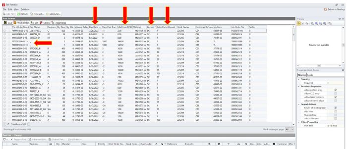

For example, the ability to customize ProNest led to additional projects courtesy of Standard Iron & Wire Works’ IT team, led by Dan Welter. This includes classification of parts to better track what’s needed and when.
“Due to an uncontrolled process, we had been cutting more parts than needed, destined for press brakes,” Toop recalls. “We would add parts to a sheet because we had room on that sheet, and ended up throwing them away because we already had too many of those parts. Now, thanks to Dan’s work, we developed part classes based on their value and demand. We can check to see what parts are needed, and their value, and then determine if we want to cut more of those parts to fill a sheet. Now we only run extra parts as they’re needed, because we know what we have on hand. For example, if we know that a part is a service part, we only need 10 of those. No need to run extra because they have nowhere to go.”
Other custom software additions include the ability to filter for specific material at specific plant locations and filter for expected feed rates for jobs, as well as generate customized reports. And, ProNest allows the ability to better save jobs and reports, as the old software only saved to a set amount and after that would begin overwriting, according to Toop.
