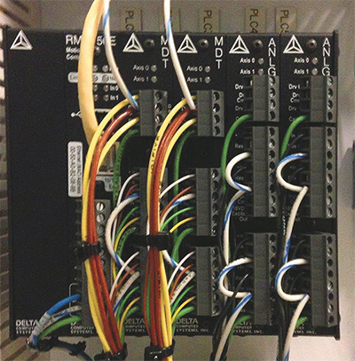

The four cylinders in the new press mount beneath the lower platen and push vertically to close the press, which is capable of operating in two modes—full-platen mode to press a single, very long part, or split-platen mode to independently press two parts. Setups for both modes employ features of Delta Computer Systems’ RMCTools development software, which drives the RMC151 motion controller.
One of these programming features, custom feedback, enables the motion controller to perform mathematical or logical operations on a feedback value, or combine the inputs from multiple feedback sources. The result is then incorporated as a single feedback value into the closed-loop control algorithm.
In Missouri Metals’ press system, cylinder positions must remain level during press operation. To accomplish this, custom feedback averages position inputs from the four position transducers, which provides a target position for all cylinders to hit during the next control cycle. In addition, individual force values derived from each cylinder’s differential-pressure transducers are summed to calculate the total system tonnage value, which then is compared with the force target value in the controller for use in the controller’s own closed-loop force calculations.

Setting up cascade control involves dedicating two of the controller’s motion axes to each cylinder, the inner loop set as a regular and faster closed-loop control axis and generating an output to the cylinder’s proportional valve, with the slower outer loop set as a ‘cascade’ axis, whose control output is used internally by the motion controller to provide a motion target to the inner loops. The overall system is controlled by writing commands to the outer-loop axis. All of this functionality is set up via simple write operations to registers within the RMC151, so no complex motion programming is required.
The press uses feedback from linear magnetostrictive displacement transducers attached to the sides of the cylinders to measure the position of each cylinder, and pressure transducers mounted in the cylinders, one on each side of the piston, as feedback to measure the force being applied by each cylinder. The outputs of the motion controller connect to four proportional servo valves that operate the cylinders.
During the initial steps of the cycle, the motion controller is set to control the position of the outer loop, ensuring that the individual cylinders are level while monitoring and limiting the total force being applied. The final step seamlessly transitions to force control, ensuring that the press applies the specified tonnage.
