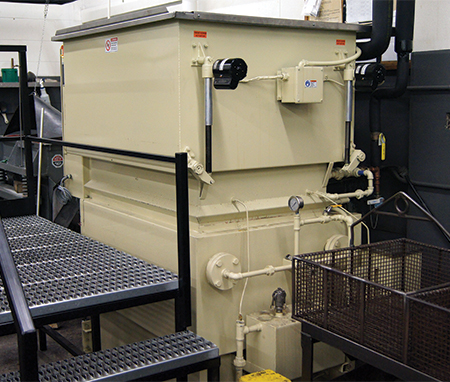

Blackstone from DGB Sales recommended upgrading the company’s cleaning equipment from an open-top vapor spray machine to a new submersible vapor degreaser that allows parts to be dunked, soaked, cleaned and dried in one operation. LCS Co. chose a 9-sq.-ft., 125-gal. model with cooling, working-mode cover and super-heat systems.

Specializing in electric-motor laminations and with about 80 percent of its parts featuring special electrical coatings, company personnel noticed that sprayed TCE would soften the coating, causing the tightly racked and stacked parts to stick together. This problem required additional labor to pry the parts apart and then to re-inspect and re-clean them if necessary. Tergo MCF, with its low surface tension and low viscosity, cleaned all part surfaces without damaging the substrate or coating.
