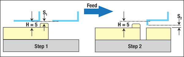

In most progressive dies, bending of the feed stock is required to produce the desired part; oftentimes bending is the dominant forming mode. After the feed stock is bent, it must be lifted above the die surface in order to advance to the next station (Fig. 1).
To determine the required feed height for a given strip layout, the designer must evaluate the lift height at each die station. Lift height, H, equals the greatest lift distance at any of the die stations (step 2 in Fig. 1), plus the safety factor.

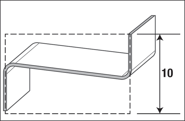

Hmin = the minimum possible lift
Hmin = S (safety height)
Hmax = the maximum possible lift, equal to the height of an imaginary rectangle that encloses the formed part (Fig. 2) plus the safety factor, S.
For the process illustrated in Fig. 1:
Fh = 100 – 90 x (8 – 2) / (10 – 2) = 32.5

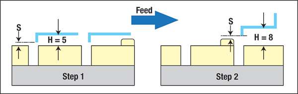

When combined with the other primary factors—station number factor, moment balancing factor and strip stability factor—the designer can now compute a final evaluation (Ev) score for the strip layout. In doing so, he may seek to increase the feed height factor to increase the overall evaluation score. Feed height factor can be improved by altering the two bending sequences (Fig. 3). For this revised process:
Fh = 100 – 90 x (5 – 2) / (10 – 2) = 66.25
