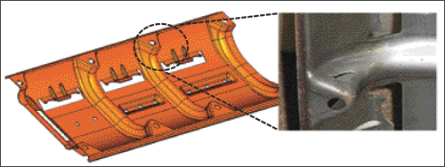

The metal stamping shown here (Fig. 1) is splitting in a highly strained area. The problem occurs intermittently and unpredictably during production, causing the stamper to experience excessive machine downtime and high die-maintenance costs. The manufacturing team concludes that the stamping process lacks robustness, since small changes in material properties, lubrication and restraining forces contribute to the necking and splitting issue.

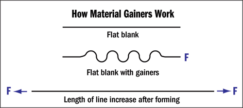

After careful consideration, engineers decide to add material gainers—embossments in the blank that help to more uniformly distribute strains (Fig. 2). This is accomplished by increasing the local length of line in the problem area. The increased length of line then is displaced into the critical area as the stamping forms; eliminating the splits.

When forming a material gainer, the stamper must ensure that the edge of the blank does not “draw-in” when forming the embossments. Otherwise, there will be minimal increase in the length of line.

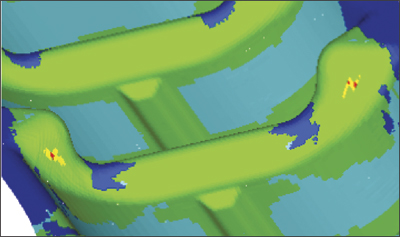

Having obtained accurate die-surface data and material properties, computer simulation can occur. The initial results for the problem part (Fig. 3) nearly match the failures we see in the actual stamping. Since the simulation model now matches our real-world results, we can begin to develop the material gainers.

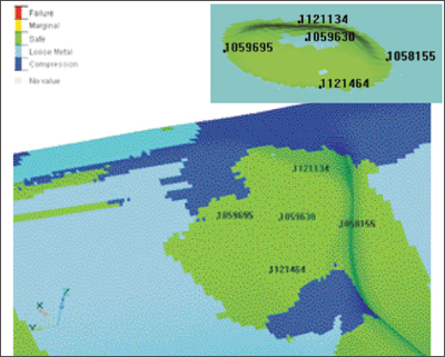

Establishing gainer size and locations will require some trial and error. The best to track results is to identify a few nodes on the blank using the finite-element mesh. In this instance, five nodes were identified. The nodes are tracked during forming simulation until achieving the desired results—no failures (Fig. 4).
The five nodal locations chosen allow the gainer to be accurately described. The height, shape and angular location can be determined and the data passed to engineering and the toolroom. Since the initial simulation showed good correlation between the computer model and real-world results, the die maker can proceed with a relatively high level of confidence. MFView Glossary of Metalforming Terms
