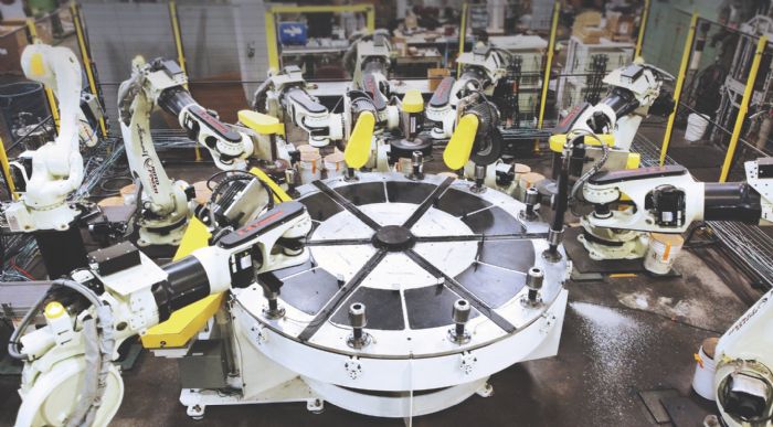

The completed automated-finishing system features an indexing table that allows a formed or fabricated workpiece to be rotated to a specific position. Surrounding the table: seven flexible, heavy-duty Kawasaki Robotics BX200L industrial robots —featuring payload capacities of 200 kg and horizontal reach of 8.5 ft.—and a high-speed Kawasaki RS020N industrial robot.

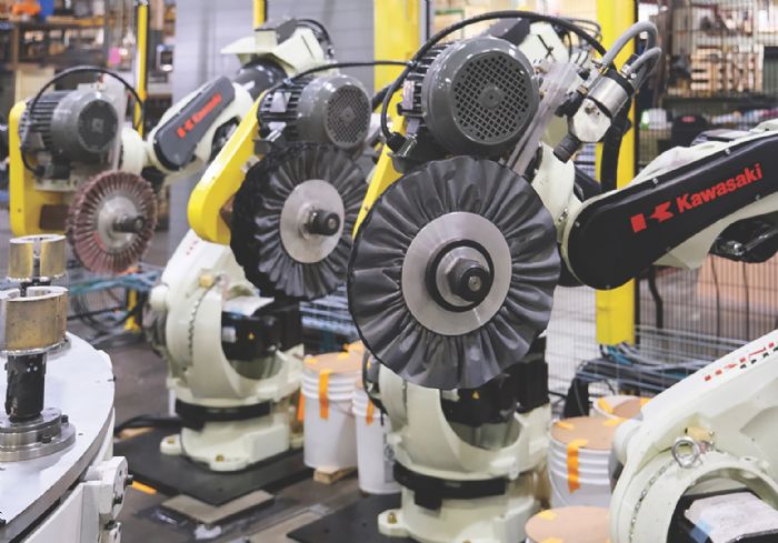

The BX200Ls feature hollow wrists for housing cables and hoses, and lightweight arms to provide functionality, flexibility and efficiency to perform two stages of polishing, two stages of buffing, two stages of color buffing and a clean wipe. The RS020N features dual-ended end-of-arm tooling that removes each finished part from the index table and places an unfinished part on the station for simultaneous processing. The finished parts then transfer to a conveyor for further handling and packaging.
“By using robots instead of instead of dedicated heads on rails, if we had an issue with the automation path, we could just touch up the program without having to make mechanical changes to the system,” Hammond says.
Per the customer, automating the process resulted in reduced cycle times and improved quality control via consistent and repeatable finishing. It had required a production KPI of less than 15 sec./part in each finishing step, and each step met this target, with the indexing table served by multiple robots ensuring that a part could be unloaded every 12 sec., thus maintaining throughput. And, the indexing table allows parts to move efficiently through multiple finishing stages—outer wall, face and radius—without the need for separate dedicated stations. In addition, the system’s compact layout optimizes the use of floor space, leaving room for maintenance access and improving operational efficiency. MF
