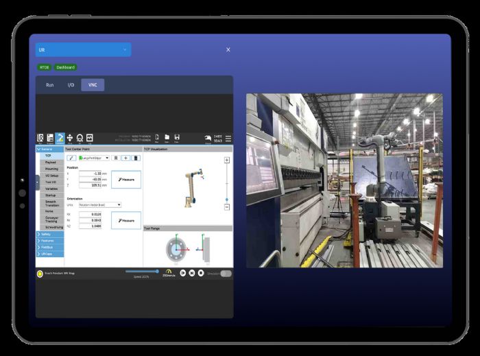

app from Olis Robotics with all of its new robot deployments. The Olis app turns
Android smartphones and tablets into gateways for any automation cell without
requiring additional hardware, enabling remote monitoring, diagnostics and
error recovery for industrial robots and collaborative robots (cobots). Users simply
download the app for a fee, connect an Ethernet cable to the controller,
configure IP addresses and begin collecting diagnostic data, with full setup
typically taking less than 5 min. The app also synchronizes real-time video
with system logs for a complete picture of issues, allows setting alerts for
irregular activity and supports screen-sharing for collaboration.

Olis provides Mid Atlantic's service team with immediate access to robot outputs, inputs, live video and telemetry data, allowing the team to rapidly diagnose issues remotely, according to Mid Atlantic officials. This capability proves vital for problems that often are difficult to articulate and explain over the phone—such as when users attempt to introduce new complex parts.
“A scenario perhaps above their skill level,” says Mayse. “Before, we would go out in the field to help them program. Using the Olis app, we now get a comprehensive understanding of what is going on—we can see all the outputs and inputs of the robot synchronized with real-time video and system logs. This enables us to troubleshoot everything remotely, optimize programs and basically see what our customers are seeing in real time. It really helps our service team manage our rapidly growing install base, while delivering a superior customer-service experience.”
And, “the Olis solution has been tremendously helpful in training new users with many questions,” says Mayse. “We simply jump right into customers’ robot cells virtually and remotely show them on the robot’s teach pendant what they need to be doing and fix it very quickly. By involving customers in the troubleshooting process, they gain the knowledge necessary to resolve future issues independently.”
