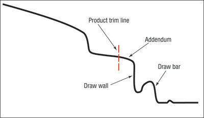

Addendum features added on beyond the product trim line.
Fig. 2—Addendum features added on beyond the product trim line.
Difficult and irregularly shaped product geometries often require the use of addendum to improve material flow. Commonly used addendum features include draw walls, draw bars, material gainers, take-up beads, pillows and punch extensions. Addendum features are added beyond the product trim line (Fig. 2) to assist material flow by balancing cross-sectional lengths of line and providing a constant depth of draw.
Designing draw-die addendum is not a simple task and is too complex to address in detail here. However, when addendum is required it is extremely important that it be designed correctly. Since aluminum is expensive and addendum (which means to add on) requires additional trim material that ends up in the scrap container, shortcuts inevitably occur for the sake of material conservation. Avoid this temptation no matter how much pressure is applied by others to keep material consumption within budget. Nothing short of a total redesign can compensate for a draw die with poorly engineered addendum. When a new die with proper addendum design is built, the added material cost will pale in comparison to the die maintenance, press downtime and expedited shipping costs incurred with alternative designs that supposedly save money on material costs. MF
