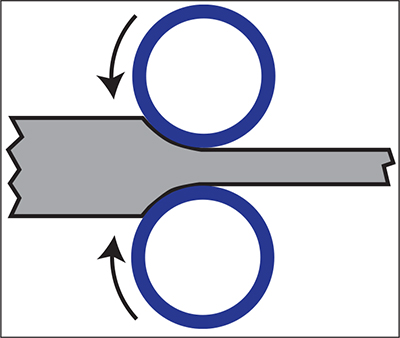

Fig. 2—Rolling converts a slab or ingot to sheet.
All steel and some aluminum mills convert liquid metal into a solid form via continuous casting, with the discrete solid units referred to as slabs. One heat can produce 10 or more cast slabs. Most aluminum mills, as well as mills working with other metals and alloys, cast liquid into individual units called ingots. Sometimes alloying elements segregate during solidification, especially during ingot casting. This may lead to a variation in chemistry in different locations, such as at the surface as compared with the center. However, the bulk chemistry remains the same as when the material was liquid.
Rolling comprises the next major processing step in the conversion of a slab or ingot to coiled sheet (Fig. 2). Here, thickness is reduced in a way similar to the use of rolling pins for flattening dough. Sheetmetal requires more rolling force than bread, so initial rolling occurs at a high temperature, hence the term hot rolling. Elevated temperatures deliver an easier way to make larger thickness reductions in succeeding passes. Because width does not change, the metal band elongates with every thickness reduction, while also increasing speed through the rolling mill. Most sheetmetal grades slow-cool in coil form, while faster cooling rates change the microstructure to increase strength. For at least some grades, hot-rolled alloys can carry the same strength and ductility as cold-rolled grades, but usually with different property ranges, wider dimensional tolerances and rougher surfaces.
