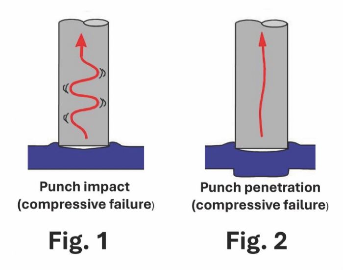

Fig 1 & 2Step 1: The punch travels downward and hits the sheet metal, transferring a great deal of shock up through the punch.  As the punch begins to enter the sheet, the sheet begins to deform slightly—the amount of deformation depends on the material’s ductility, sheet thickness and the clearance between the mating die sections. Using excess clearance value can result in tensile failure (and pull the slug out), while insufficient clearance value can lead to compressive failure (and push the slug out)—Fig. 1 and 2.

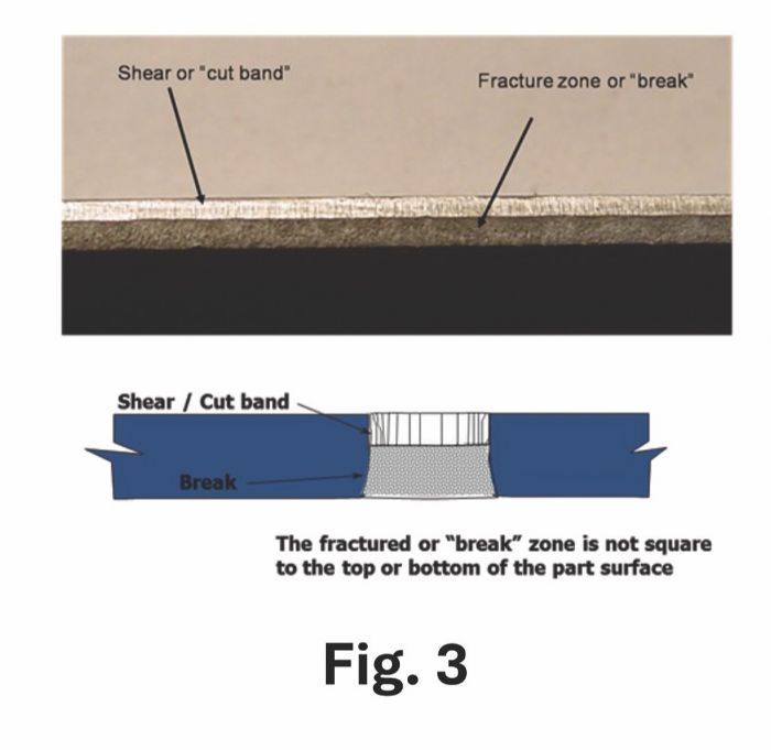

Step 2: As the punch continues to travel downward, it begins to push out, or cold-extrude, the sheet metal. This creates the sheared portion of the cut, or the “cut band,” Fig. 3.
Fig. 3Step 3: Once the shear strength of the sheet metal has been met, it begins to fracture or break away. Shear strength, a value similar to tensile strength, represents the maximum shear stress that a material can withstand when subjected to two bypassing planes. This process produces a cut edge with a shiny portion—the cut band or shear zone, and a portion called the breakout or fracture zone. With most conventional cutting operations, the thickness of the cut bend typically is 20 to 40% of the sheet thickness, Fig. 3.

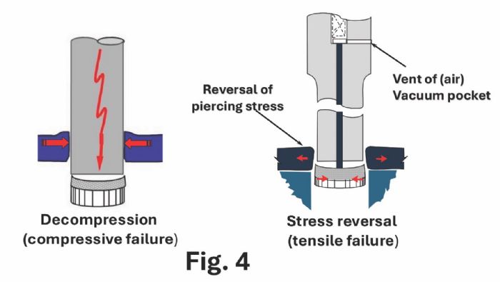

Step 4: After the cutting punch has performed the necessary work, the sheet will decompress and tend to stick to the punch. This is especially true when using smaller clearance values. However, when using a larger clearance value, the material in the apron area around the punch will retract, resulting in a hole larger than the diameter of the piercing punch. Using a larger cutting clearance not only will result in a big reduction in stripping pressure but also will reduce the force needed to generate the cut features. Reducing the interface between the material and the punch also decreases the amount of erosion and wear occurring on the sides of the pierce punch, Fig. 4.
Fig. 4Step 5: At this stage, the punch direction has been reversed; the punch retracts from the hole—called punch stripping.
