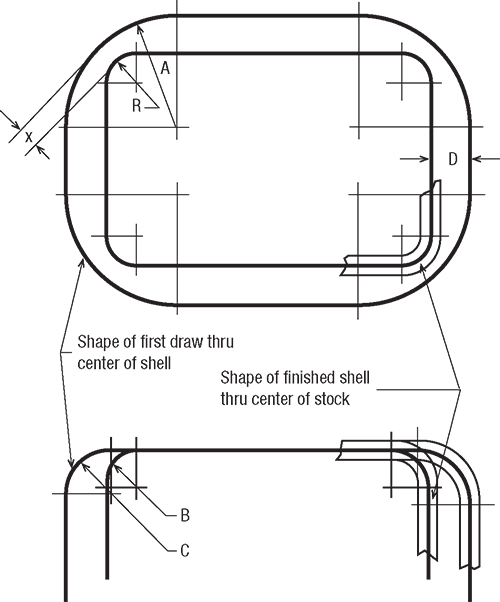

The amount of reduction between redraws depends on the corner radius, which shrinks incrementally with each reduction. When two or more reductions are required, take these steps to determine the length and width of each shell:
  • Starting with the finished part geometry, multiply the corner radius by 3.
  • Multiply using a constant of 0.75 on corner radii greater than 1/2 in., regardless of the corner size.
  • Add the product for the calculation above to the current length and width, which will be the length and width of the preceding draw shell.
The corner radius for the previous draw will be approximately four to five times larger than the final part. Do not lay out the new radius from the centerline of the final part. Instead, it should provide a small ledge from which to draw. Redrawn to its final shape, a large portion of the part material in the corner will flow into the sidewalls with little compression. Fig. 2 depicts this method, where:
Fig. 2—Relationship between the first draw and redraw (from Die Techniques)
R = Corner radii of the finished shell
A = 5R
X = approx. 1⁄8-in. drawing edge
D = 3R; or 0.75 in. when R > ½ in.
Ensure that the punch-nose radius, around the top of the draw punch, is equal to or larger than the corner radius along the straight sides, and gradually increase to the same size as the corner radius in the corners.
To determine the punch-nose radius size for first draw and final redraw operations, follow these steps:
  • The inside dimensions on the final part drawing will equal the corner radii and punch-nose radii for the final redraw punch.
  • The corner radii for the first-draw punch equals radius A in Fig. 2, minus half of the material thickness.
  • The punch-nose radius C is the sum of the wall reduction distance D plus one-fourth of the final punch-nose radius (D+1/4B in Fig. 2) minus half of the material thickness.
  • To illustrate, assume that the punch-nose radius along the flat sides for the final redraw in Fig. 2 is 0.125 in. and D is 0.375 in. The punch-nose radius along the flat sides for the draw die would be 0.375 + (0.125/4) = 0.406 in. Now subtract half of the material thickness to establish the final radius size for the punch.
  • Blend the punch nose radius around the corners of the punch face to match the vertical corner radii. This provides a corner that looks somewhat spherical, or “balled off.”
