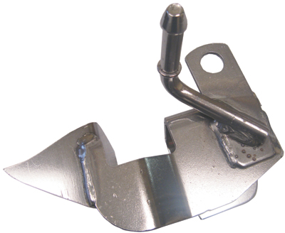

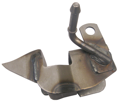

Burnishing of stamped parts and assemblies smooths the surface peaks into the valleys, producing a highly reflective finish. Finishing the weldment shown here involved removing loose weld spatter and discoloration, accomplished during a 15-min. process using steel media with an acidic cleaner.

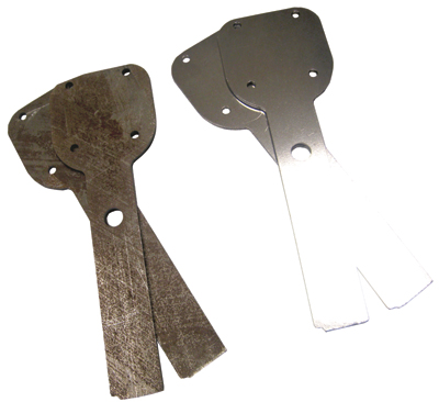

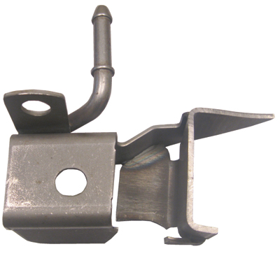

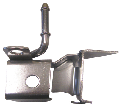

Finishing (edge breaking) the parts labeled A occurred in a 10-min. continuous-flow process with steel media. Rust removal and edge breaking of the parts lableled B occurred in a 30-min. batch process that included use of an acidic compound.
Growing in popularity among metal stampers, according to the Dyers, is use of continuous-flow vibratory finishing. In stamping, they say, about 80 percent of the objective with finishing is to create parts free from sharp edges to enable safe handling during assembly and packaging.

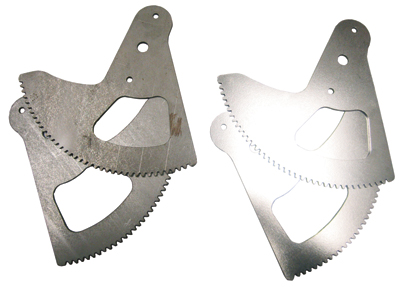

For more aggressive finishing applications with small to midsized parts, the Dyers note more stampers opting for the centrifugal-disk (CD) process. CD finishers typically operate 10 to 20 times faster than standard vibratory-finishing equipment. These units are specifically designed for removing heavy burrs and for intensive radiusing, and, notes Tim Dyer, they provide optimum batch-to-batch integrity since the machines empty completely after each run.
CD machines feature a spinner on the bottom of the bowl that rotates to create centrifugal force that drives high-speed part movement through the finishing media. The process proves ideal, the Dyers say, for finishing flat parts that tend to stick together during finishing—washers, seatbelt buckles, hardware and fineblanked parts and the like.
