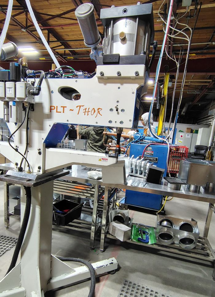

press-lock-metal-clinching-machinePress Lock customized a standard machine to fit Airvent's available floor space, allowing it to build the machine stand themselves. “We were turned away by other firms that only offered us their standard products,” Chohan recalls. “Press Lock’s ‘nothing-is-impossible’ approach helped us develop a collaborative solution in a couple of weeks.”
Chohan also appreciates Press Lock’s support during machine commissioning. “The chief unexpected benefit was the rapid response to debugging issues,” he says. “Their team was onsite in most cases within 12 hr. and resolved issues with minimal follow-up from us.”

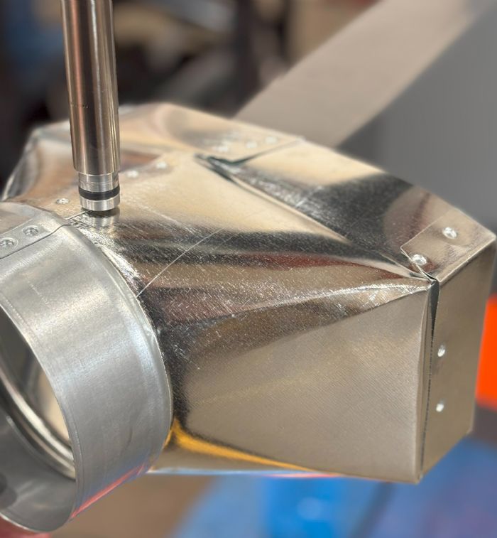

Per Press Lock’s website, the clinching process joins two layers of sheet metal together with a mechanical interlock joint. Tooling forces the sheet metal on the top layer into the second layer, forming a permanent press fit. All process steps happen within a second or less.
airvent-metal-products-clinching-technologyThe only challenge the team faced, explains Chohan, involved part design. “Our components were designed for spot welding, with narrow flanges,” he says. “Clinching requires a slightly larger flange to accommodate the die landing. We quickly addresses that challenge by modifying the part designs, fortunately with no loss of material yield.”
Clinching also has provided more consistent joint quality. "The consistency of joints cannot be compared to spot welding. Our only rejected parts have been due to operator error, not machine inconsistency."
