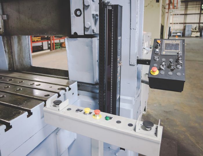

link-operator-terminal-light-curtain-haley-toolOf note: The motivation to upgrade and retrofit new press controls came from a Kloeckner energy-sector OEM customer request to add takeover tooling for a high-volume stamping job. Haley Tool operations manager Scott White explains:

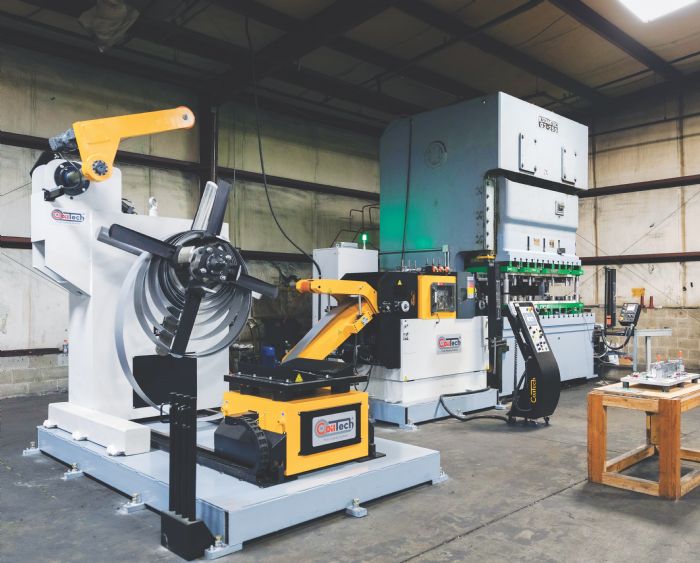

The overall capital program, then, included upgrading an existing 250-ton Stamtec mechanical press with a new state-of-the-art Coiltech feed line (15-in. width capacity), new controls and light curtains; and the addition of a new 440-ton Seyi mechanical press (120-in. bed). In addition, the capex program included the purchase of a used and refurbished 275-ton Stamtec 144-in.-bed press, with upgraded light curtains; and it added a new control system and light curtains to an existing 400-ton Niagara press, along with a new Dynamatic digital controller.
“It’s the new feed line, and the need to ensure precise synchronization between feed and press, that added extra motivation to upgrade our press controls,” White says. “And, with the upgraded controls we also wanted to elevate our ability to add and use sensors to our tools, for die protection and to help optimize press run times. And, of course, the new controls provide optimum operator safety, very important to us at Kloeckner Metals.”

“To prepare the pressroom for growth and increased high-volume production,” says White, “we knew we needed a new feed line, which then helped to justify the investment in new press controls and die protection.”
To date Haley Tool has upgraded three presses with Link 5100-MPC resolver/encoder-based units, along with Link’s Black Max safety light curtains. And, it expects to upgrade the controls on several additional presses in the coming months.
Carter and White both are quick to acknowledge the help of Link Systems’ preferred installation team at J. Williams & Associates, a manufacturers’ rep firm in Rittman, OH, in installing the new controls in a timely manner so as to not interrupt production.
Among the list of 5100-MPC features:
  • OmniLink 801 operator touchscreen terminal
  • Intelligent diagnostics
  • Storage and quick recall of as many as 100 jobs
  • 6 to 2000 strokes/min. working range
  • Operating modes: off, inch, automatic timed inch, setup/stop time test, single stroke and continuous stroking
  • Dual-limit stopping-time-performance (brake) monitor
  • Clutch-engagement-time monitor
  • Automatic top-stop compensation for variable-speed presses
  • Two configurable part-counter groups driven by stroke or sensors that can count actual parts into a bin
  • Configurable hardware and software for a wide range of lubrication systems, hydraulic overloads, and flywheel brakes
  • Four configurable die-protection inputs.
Both control-system installs also included tonnage monitoring and light curtains—important additions, per White.
