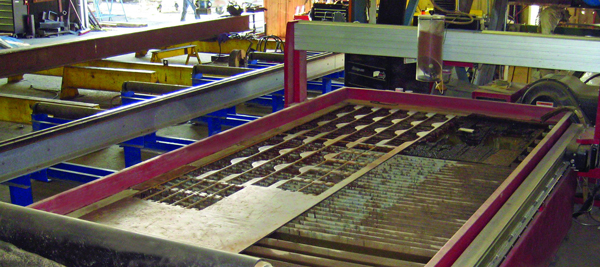

The Maxiem 1530 JetCutting Center at West Coast Steel Fabricators produces parts that are beautifully finished right off the machine. It has eliminated as much as 2 hr. of finishing time from most parts, as well as the man-hours usually spent deburring and cleaning. |

Where the Maxiem 1530 really shines, says Hough: producing parts that are beautifully finished right off the machine. It has eliminated as much as 2 hr. of finishing time from most parts, as well as the man-hours usually spent deburring and cleaning.

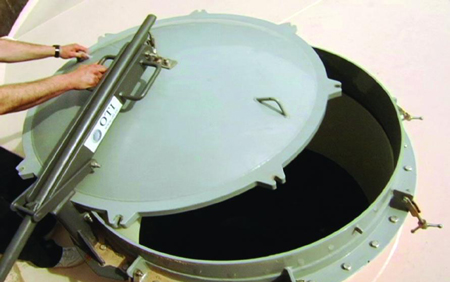

Recently, the shop added the Omax Collision Sensing Terrain Follower accessory to its cutting machine, which contends with cutting uneven part surfaces. The accessory has proved particularly useful for cutting parts for OTI—Hough’s anaerobic digestion-equipment division. Prior to adding the Terrain Follower, when the waterjet-cutting head would encounter an uneven surface, the machine would automatically shut off.
“Initially, we did not realize the need for the Terrain Follower,” recalls Hough. “Fortunately, we were able to retrofit the device to our machine. Now, if our plate stock has a bit of a wave to it, the machine just follows along seamlessly and without any issues or special programming.”
Recently, the shop added the Omax Collision Sensing Terrain Follower accessory to its waterjet-cutting machine, which contends with cutting uneven part surfaces. The accessory has proved particularly useful for cutting parts (shown here) for OTI—Hough’s anaerobic digestion-equipment division. Prior to adding the Terrain Follower, when the waterjet-cutting head would encounter an uneven surface, the machine would automatically shut off. |
