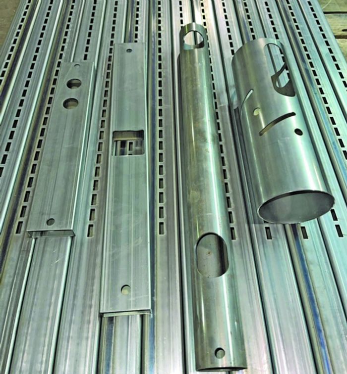

“We took delivery of the cutting machine early in 2019, and it has served as a great entry into laser cutting for us,” Charon shares. “It fits us like a glove. Much of the work we cut is very thin-walled, typically ¼ in. and thinner. We get great cut quality as well as throughput from the machine, whether cutting with air assist or, in some cases, oxygen for cutting tube thicker than 0.065 in.”

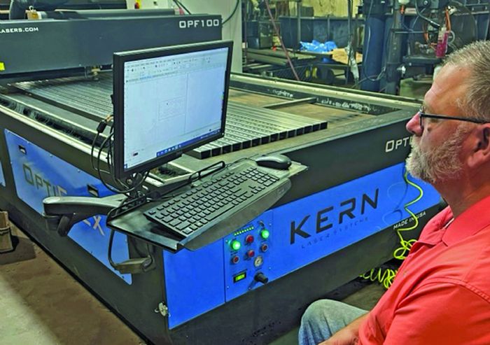

Navigating the learning curve, Charon points to learning to use the Kern programming software, understanding how to vary laser power as needed, and when to use oxygen or shop as the assist gas—and how much gas—as key knowledge bites. “And, many of the process parameters change whether you’re cutting square or round tube sections,” he explains, “partly due to the tube geometry. Square tubes have variable wall thickness since material gathers in the corner radii, so we must adjust cutting-process parameters accordingly. We also experience variable cut quality depending on the tube supplier, its recipe for creating a particular alloy, and its production process. To adjust at the laser cutting machine, therefore, we’ve developed numerous recipes for piercing and cutting based on the specific workpiece at hand. We probably have some 200 recipes stored in the machine control, and we’re setting up and programming at least one new job/week.
“To learn the machine and become trained, we didn’t hire a laser expert,” Charon continues. “We trained ourselves, along with the support of Kern’s technician who spent a week here helping us get set up, including developing the set of fixtures we needed. And, long after he left, we continued to receive help from Kern as needed. We now have three employees trained on the machine, including me.”

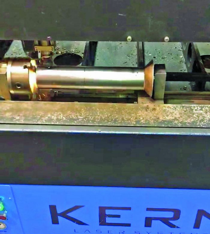

On the hunt for an affordable laser-cutting solution, Charon, after some preliminary investigating, set course for FABTECH 2018 in Chicago, where he met with the team at Kern Laser Systems, Wadena, MN, and took a close look at its OptiFlex CO2 laser cutting machine. Quickly convinced that the machine would fit the bill, VanRon ordered a 400-W Kern model OPF60120 with a 5 by 10-ft. worktable, equipped with an optional rotary-chuck attachment for tube work. Driven by a high-resolution servo motor to provide smooth, accurate cutting, the lathe chuck firmly secures each tubular workpiece in place. A tailstock pushes up against the opposite end to keep the workpiece rotating on center as the laser cuts. The tailstock can be adjusted on a rail for different lengths, and adjustments to the rotary chuck accommodate tube to 6-in. dia.
