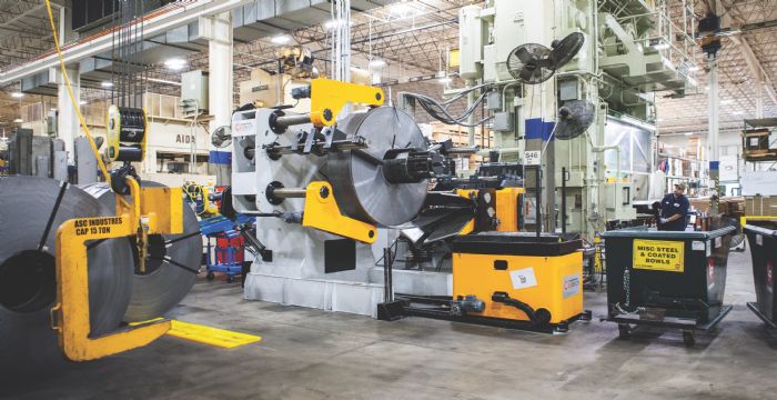

1-Coiltech-Stanco-heavy-duty-coil-feed-compactToday, under the leadership of Stansberry’s granddaughter Linda and her husband Gerald Slagel as COO, the certified Women’s Business Enterprise manufactures parts for—in order of volume—appliance, lawn-and-garden, solar, data-center, automotive, HVAC and office-furniture customers. To be nearer to its customers in these diverse markets, Stanco, besides its now 135,000-sq.-ft. plant in Grand Haven, has added a 100,000-sq.-ft. facility in Williamston, SC, and another facility in Santa Teresa, NM, that occupies 180,000 sq. ft. The three operations total nearly 400 employees across three shifts who operate 47 stamping presses in capacities from 150 to 1400 tons. Other processes performed include welding, assembly and inhouse tool building. The New Mexico operation, heavily involved in data-center work, also employs fabrication equipment such as press brakes, laser cutting machines, turret punch presses and a powder-coating line.

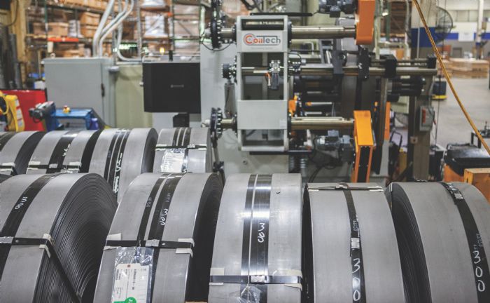

2-Coiltech-material-Stanco-heavy-duty-coil-feed-compactOf course, thicker, tougher material requires bulked-up coil feeding—conventional coil lines just can’t handle it. Recognizing this, Stanco has invested in compact, heavy-duty coil-handling lines from CoilTech North America, Detroit, MI. The first, a 50-in.-wide line installed in January 2024, serves a 1400-ton stamping press in Grand Haven. The second, a 40-in.-wide line, was added in November 2024 to feed a 1000-ton press, also in Grand Haven. Both lines, serving recently purchased used and refurbished presses, are compact lines measuring 18 ft. long, owing to limited space on the Stanco-Grand Haven shop floor. The lines feature common components to enable quick swapping if needed to keep a line running. Upper and lower backup support rolls on these lines bring robustness, and cutoff shears between the feed exit and press window on each line allow for running of partial coils, according to CoilTech officials. And, this past September, CoilTech installed a heavy-duty 40-in.-wide conventional-length line at Stanco in New Mexico—ample floorspace at the facility precluded the need for a compact line. All three lines are fully programmable, automatically adjusting settings according to job number.

In particular, he calls out the pilot-release straightener roller assembly that briefly disengages the top straightener rollers, enabling precise material positioning in a progressive die. This capability prevents pilots in the die from fighting against the tension of the straightener rolls, thus ensuring feed accuracy with heavier-gauge materials.
“The 8-mm-thick HSLA Grade 80 is a brute on the dies, and a brute on everything in the press line,” adds Zimmer. “We knew that it was tough to form, and we had a learning curve on the die side. For example, we needed a lot more spare die details on hand than we’d ever need for conventional steel because the thick Grade 80 steel is like cutting concrete.”
