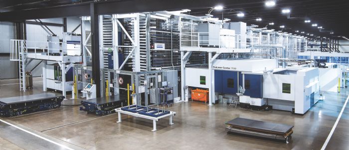

As technology providers consistently update integrated hardware offerings, Chakraborty hopes to see them also begin focusing on integrated systems from the software side. By this he means open architecture. He cites the advent of third-party nesting and related software that had allowed fabricators to install laser cutting machines from various makers that run under a single software umbrella.
“Every technology has an Application Programming Interface (API) and the ability to output certain file types,” Chakraborty says, noting that Lantek, for example, works with these APIs and file types to create a common background that eases integration. “Today, we are working on projects involving automation and work centers of various machine and automation brands. Tomorrow, when we see a storage tower from one vendor teamed with a laser cutting machine from another, we’ll be ready.”
While fabricators can select work center components from various vendors, it’s an extremely difficult proposition. Chakraborty puts the onus on machine, automation and software vendors a well as integrators to unite for a solution that gives end users opportunities to fashion custom solutions more easily. As we’ve seen, highly automated multi-process work centers are here, and we’ll see just how their communication capabilities evolve. MF
